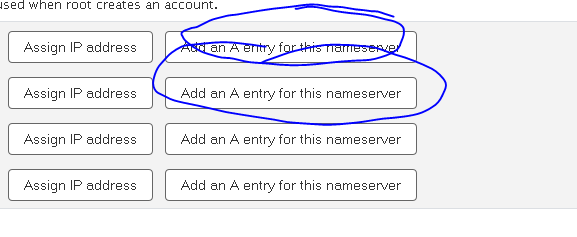

Thanks a ton for your guys help. It turns out I missed a step. In the spirit of helping others learn from my mistakes, I went step by step through the process listed here. In my case I neglected to click"Add an A entry for this this nameserver".
All is well, thanks again guys.
